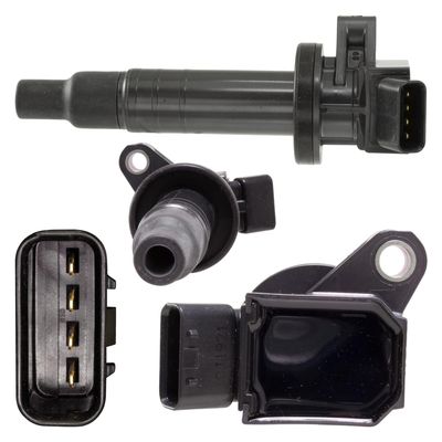

if you remove the Ignition coils ... inspect them for signs of high voltage leakage...
you will want to open the hood in the dark... with the engine running... look at the top of the coils.. do you see any small purple sparks from the coils... ????? that would indicate that you need new coils... coils are over 100 bucks each.. sorry..  and there are 4 of them..  yep... be glad you don't have a mid 90s jag.. with coils at 750 bucks a pop... and need six at a time..
check the boot for signs of high voltage leaks thru the side.. around the end where it pushes down over the spark plug insulator...
this does make random misfires...

with a scan tool.. if you get Other than a P0300... and you do get something like a P0301, P0302, P0303, P0304...  i would mark the coils for location...
and i would SWAP their location ...   then drive the car.. see if the misfire follows the coil swap..   this usually requires a proper scan tool.. so you can check the codes... and clear them at will...
