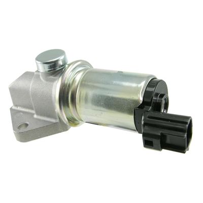

did i ever give you the link to motorcraftservice  dot com??   and have you download the obd2
this is the idle air control valve... it gets clogged with carbon... take it off.. hold it electric end upwards and blast it out with some brake cleaner...  then shake it out..
you will also want to remove the air inlet duct into the throttle body...
have somebody hold the throttle wide open.. ENGINE OFF of course...  spray some brake cleaner on a rag and wipe the carbon from the bore where the blade closes..
try NOT to fill the motor with any spray.. its really easy to damage it..
once you do this.. you may have to hold the pedal part way open to start the engine and get it running.. once its running.. hold the speed steady for 20 or 30 seconds.. then very slowly.. take about a minute to reduce the engine speed to idle... this will let the engine learn the amount of bypass air...
you may still need to change the idle air control valve.. they are about 50 bucks in some stores..  and they do wear out electricaly.

I guess the idle air control valve is on top of the intake manifold, maybe on the throttle body?
I just ran the truck down to the gas station and put some unleaded plus in it with a dose of the STP injector cleaner, the black bottle, in it.  It did feel as if it had some roughness in the idle on the way back to the house.  We've been known to have bad gas around here but I don't know where it was that my daughter filled up last.  I've never put much stock in the injector cleaner products but now and then I don't think it will hurt.
I'll pull the IACV off and look at it for sure.

how the idle air control motor works is the computer controls the voltage into this..
this is a LINEAR electric motor...
when the engine is cold.. the computer commands the valve open fairly far to allow more bypass air for fast idle and starting...
as it warms up.. the computer starts closing the valve to slow the engine to a normal idle..
if there is carbon build up.. it might not be able to command it open far enough to start the engine..
carbon build up around the throttle blade also reduces the amount of KNOWN bypass air... this forces the computer to attempt to open the idle air control valve farther each time...
but it can ONLY open so far...
if it hangs up... you won't have enough air to start the motor...

Ok, found the IACV on the top of the intake manifold and cleaned it.  It probably needed it.  The valve seat really doesn't open that much but it seems to be moving more freely now.  Didn't have time to clean the inside of the manifold but will as soon as I have time.  The truck seems to be running much better so time will tell on how well this fix worked.  Now if I can only talk my daughter in to driving it again.
