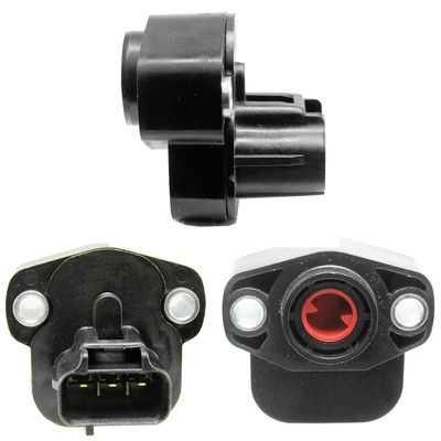

2.4 versions use this one. tps335  the 3.0 versions also use this one..

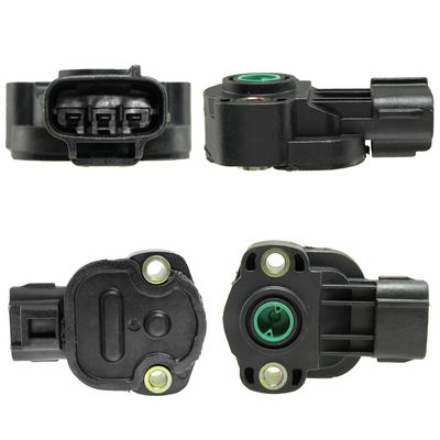

3.3 flex fuel versions use this one.. tps331
do you have the Old TPS.. that you can post a part number off of??
i did not try to look up all the variations on this as i am awaiting your info..
