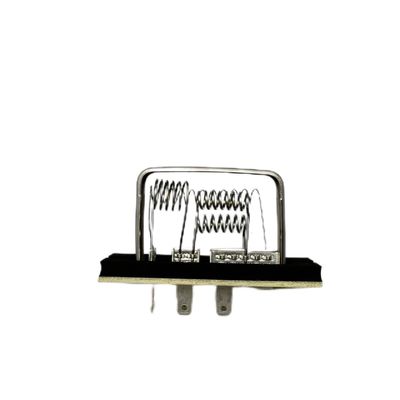

bad blower resistor... these are also rather in expensive.. under 20 bucks in some stores.

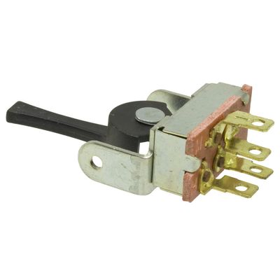

this is the front blower switch..
