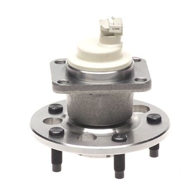

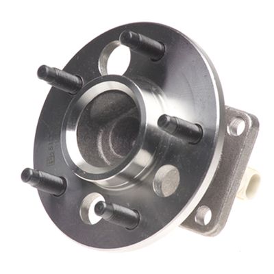

the Square flange is bolted to the suspension knuckle..  the part that connects the upper and lower suspension components ...
the round flange with the studs supports the tire and brake drum or rotor..    allowing it to spin without ANY wobble..
if you have wobble..    you either have a bad hub and bearing ...  or a broken suspension..  or something is rusted out..??????????
