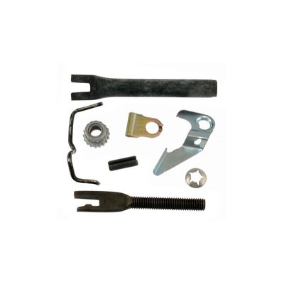

do you have drum brakes on the rear.. i would imagine..
this is the adjusting screw...
if you get under the car.. its a pain but sometimes you can adjust this with a tool through the backing plate..
why don't you try to operate the parking brake on and off about 50 or 60 times..   take a bungie cord to hold the release lever up while you  mash the pedal again and again if you have a foot operated pedal.. if you have a pull up center lever.. just push the button and go to town..
you will know that you are getting closer as you will be only able to move it about 1/3 of the travel to the bottom..
you might want to take a look at the rear brake shoes.. see if there is anything left of the friction lining..
you can also do a slip on adjustment test.. see if you can tighten up the adjustment with the drum off.  see when you slide the drum almost all the way on.. how tight it is left and right..

Posted: 04/25/12
10:38 PM
this is the left side.. the adjuster is at the bottom..
this says its the right side..
looks like this is basicly a conventional brake system.. with the adjuster at the bottom...
check the amount of wear..
these adjust that if you back up and apply the brakes . the rear shoe is pulled away from the anchor at the top and the adjusting lever turns the adjuster star wheel a fraction..   this usually only happens when you apply the brakes in reverse..  i should have looked earlier..
inspect the linings first.. see how much is left above the heads of the rivets..
