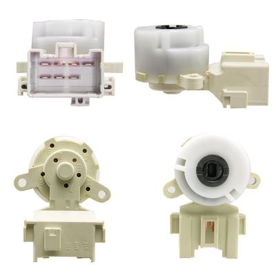

with a test light stuck into the power circuit to the coil...  not the ground circuit.. work the ignition switch from OFF to ON and then to crank.. then back to ON..  see if the light stays bright in ON and Cranking..   ignition switches have been known to fail...

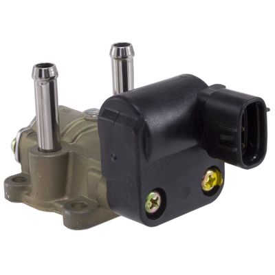

i have had the most problem on these camrys with the idle air control valve..  that carbon builds up in it. at that point it hangs up and the engine will either idle too fast.. or stall out..
these are on the bottom of the throttle body...  and you cannot easily take them off without removing the throttle body.. try not to damage the screws as they are really really TIGHT.. and they need a pozi drive screw driver tip .. not a phillips screw driver.. i usually have to have a small pair of channel lock pliers to grip the sides of the head of the screw to loosen it for the first fraction of a turn.. or the + will just tear out..
be sure to note that there are at least 3 hoses to the bottom of the throttle body.. 2 of them are COOLANT.. one vacuum..  don't get them mixed up...
i remove the screws that hold the black electrical device on the end..  then spray brake cleaner through it as i am rotating the knob carefully until it turns free.. it only turns a fraction of a turn.. the carbon hangs it up..  the computer varies the voltage to the black part.. this exerts variable magnetic force to the knob.. to turn the shutter valve to control idle speed..   i usually plan on an hour to remove and clean the throttle body assembly..

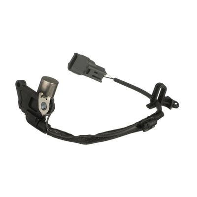

i would bet with the misfire just before the stall. that the crank sensor or the cam sensor is failing..

you will also want to go thru this...
The Crankshaft Position (CKP) sensor provides a signal through the ignition module which the ECM uses as a reference to calculate rpm and crankshaft position.
The crankshaft sensor should be tested either
   cold 14-122°F (-10-50°C) or
hot at 122-212°F (50-100°C).
Using an ohmmeter, measure the resistance between terminals.
Resistance cold should read 1630-2740 ohms
and hot; 2060-3225 ohms.
If resistance is not within specification, the sensor may be faulty.
Remove the right side fender apron seal to gain access to the crankshaft position sensor
