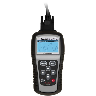

try to get a auteltech MS609..   looks like the grey earlier version above.. it does abs and air bag codes also..
