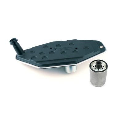

doin a little reserch tonight and found that in the tranny service manual it says when changing pick up filter to set the filter gasket before putting filter in place!? there was no gasket/seal there when i tool it off! looked it up on some parts websites and napa shows one with a small gasket and has a part num. 1-8585  every other site i look at doesnt have one listed? this could have been the original issue. anyone know?
Posted: 12/01/11
10:23 PM
item 31 shows a rubber and steel wedding ring on the top of the tube.. usually hangs up in the transmission when the filter is removed...
http://www.transmissioncenter.com/45RFE_545RFE_68RFE_Performance_Transmissions_and_Parts.htm
a link to a parts diagram..
http://www.makcotransmissionparts.com/mm5/graphics/Catalog-pdf/45RFE.pdf
you can see the seal on the filter neck..
i don't know how many of the front wheel drive 3 speed mopar transmissions i have had to rebuild do to the cork gasket being balanced on the filter.. instead of being pushed over the torx cap screws to keep it in alignment..
on gm transmissions.. with a similar seal.. i have found several wedged into the pump where the filter fits.

well if thats the seal on the neck then i'm ok, that is whatcame out and whawent back in.
Posted: 12/02/11
09:14 AM
the seal is separate....  it sometimes come out on the filter..
it sometimes comes out and falls into the drain pan..
it sometimes sticks...
it really sounds like there was a problem.. but the frictions may be all worn away..   when its metal to metal in the friction clutches.. it may engage.. but will slip when the engine starts making more torque ...
when the frictions are worn thinner..  and i have NOT been into one of these..  the pistons that squeeze the frictions and the steel plates will extend past the bore they are in.. and the seal will cut..  at that point.. you don't have any way to build pressure behind the piston ..
