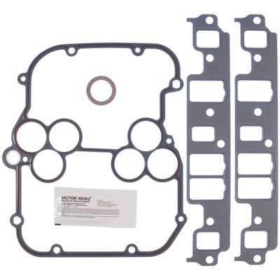

oil in the intake... getting into all the cylinders???  i have changed a bunch of the lower intake manifolds.. i was more worried about getting everything perfectly clean...  i used bath towels over the open lifter valley. tucked in between the tops of the push rods.. so i could scrape away with my 5 way painters tool that i keep razor sharp with a diamond file.. by running the sharp edge side to side down the length of the file.. so its sharp and flat..  i drag it across the flat side just once.. takes the burr off..   allows me to scrape aluminum machined without digging in ..
does this engine have a LONG oil filler tube.. or can you take the oil filler cap off ... look down in the valve cover with the engine running.    see if there is more than an inch of oil around the bottom of the springs..
i seem to recall that this version has a removable tuning port so you can see into the inside... perhaps i am wrong..
