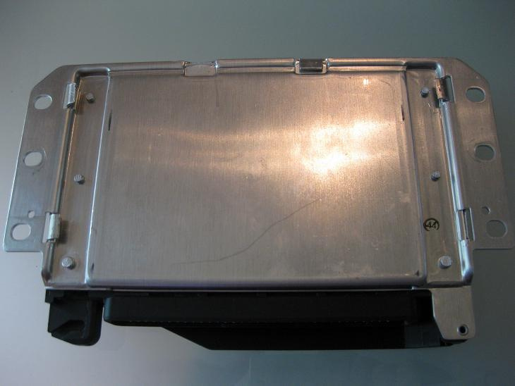

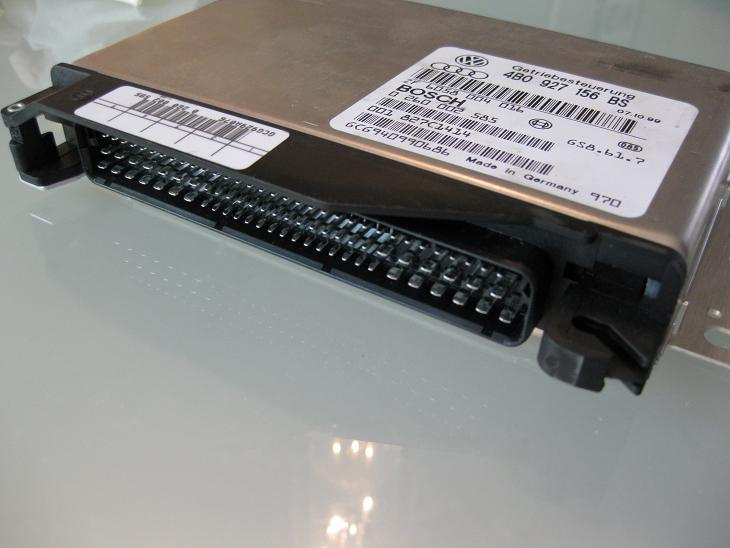

is that a bosch computer in a deep drawn case.. with the end held in with 4 screws... the wire connected with a tilt up latch???   if so..  the computer can come out of the case fairly easily..  for inspection..

Addict | Posts: 4545 | Joined: 08/09
Posted: 11/27/11
10:28 AM
P4pb6606111
P4pb6606112
you can see some corrosion in the upper right corner in the circle..

Ok.. So I let the TCM dry for a few days and I've got some progress but not enough.. so i think i am going to try to take it apart and look inside as they show in the photos you've posted.. i just don't quite understand exactly how to take it apart without breaking it!! ive been searching forums,craigslist and ebay for parts. these things are scarce!! is there a way that you know of ... that i can find out if another engine size could be programmed for my car? like an interchangeable part? hmmmm... ive been searching online and found NOTHING.
