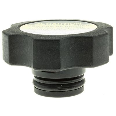

change the radiator cap for a new one....
