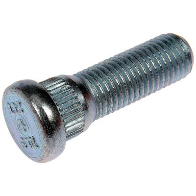

this is what the yaris wheel stud looks like
one thing.. i usually have to grind a angled flat on the head to get them in without damaging the threads... look at the old ones for how much to grind...

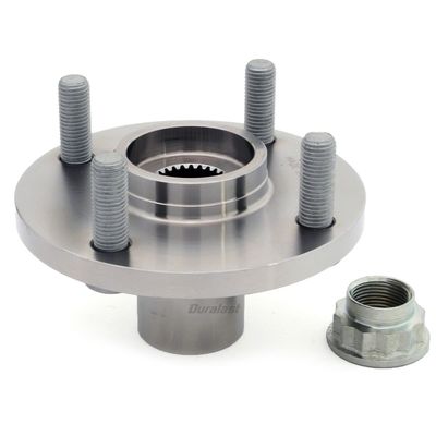

this is the wheel hub....  do you see how flat the surface is...
