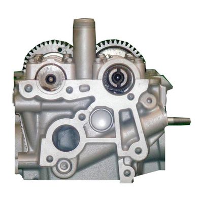

this looks like the intake side of the head...
i wonder offhand.. if the center opening has coolant in it..   so a leaking intake might leak into the intake port..
wait... maybe this is the intake side...

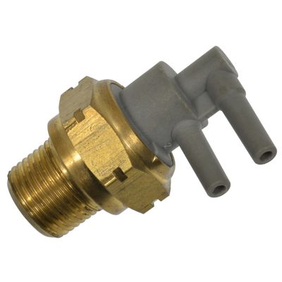

just had a flash... how about the thermal vacuum switch down on the thermostat housing...   its connected to coolant and has vacuum hoses on it..   its just above the transmission on the drivers side of the  cylinder head... mounted in the housing.. or water outlet..
i wonder if there are any more?????
