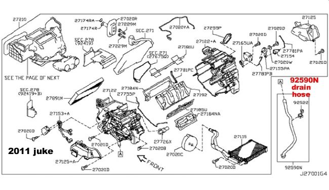

find the DRAIN hose from the evaporator box...
disconnect it and spray some of the special evaporator box disinfectant... or... even better... rig some either clear vinyl hose that's the proper size..  and with enough length to let you work OUTSIDE THE car... with the drivers door open...
use a transmission funnel... and pour some hot water and probably something like lysol liquid blend into the funnel and hold it high.. so it runs backwards into the evaporator box...  then lower the hose and let it run out..  or work it back and forth a few times by raising and lowering the end of the hose...
clean the drain hose completely also..
i don't think i would mix up more than a quart. or a quart and a half..
there are kits that allow you to drill a tiny hole in the evaporator case and blow disinfectant into the case...
some of these spray cans .. also come with a LONG LONG NOZZLE hose.. so you can feed it backwards up the drain hose and right into the box..  an interesting thought.. is to take a sharp knife and cut part way into the sides of the tube about 1/2 inch from the end.. and pinch the end almost closed.. this makes it spray from the sides.. just what you might want...
but if the case drain is clogged... you will be in trouble..
i got some images up ...
2011Jukehvaccase Zps028fa4e3
2011Jukehvacdrain Zps81a4fdbb
