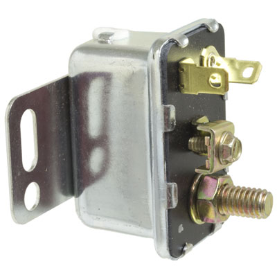

I am having the same problem I have a 1989 Jeep Wrangler 4cyl 2.5L, I'll drive even for 15min stop cut the engine off be back in 5min to crank it back up and it wont fire up, it has to sit for about 1-2 hours and then it will fire up fine.
if anyone has found the solution to this problem can you please email me at xxjolly_greenxx@yahoo.com
Addict | Posts: 4547 | Joined: 08/09
Posted: 08/02/11
09:57 AM
Icon QuoteThirt:
thirt....
i would probably say the starter may be going back..
you jeep uses a conventional mopar starter relay on the firewall..... when it fails to start with the key.. you might want to carefully short the big threaded stud to the center terminal on this device.. while the car is ready to crank...  so it won't move when the engine spins....

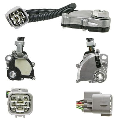

when you turn the key...  you send power through the neutral safety switch on the side of the transmission.. and then up to one of the push on terminals of the relay above....
the large threaded stud is connected to the positive side of the battery ..  the center terminal goes the starter solenoid contact... to activate the starter...
when the starter is bad.. jumping the starter relay won't do any good...
if it does start from there.. then you might have a different problem ...
starting with proper cleaning and wire brushing the battery terminals.. getting them clean...  using hot water to wash away an crud..
using the wire brush to clean the other ends of the cables where they attach to the engine block..   where the ground cable attaches to the body...
