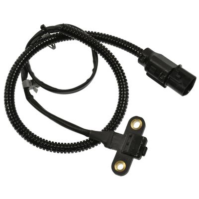

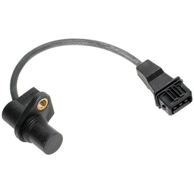

vegascoach..  you did not say if you have the 4 or the 6 cylinder motors..
thermally related failures are hard to diagnose...
there is one thing...   most scan tools have a record data setting... with 2 ways to activate it...   start the recording when the check engine light code is set.. or a manual start recording..
when the scan tools are set to record... they are actually constantly recording the data stream.. when you push the button.. it saves the prior 5 seconds or more of data stream and the 5 seconds after you pushed the button.. so you can go back and review the data stream watching for changes...
i probably would start with a crank shaft position sensor...
the 4 cylinder version...
the 6 cylinder version..
neither of these are cheep... but they are less expensive than any of the other parts  and are likely to fail at extreme high temps...  then possibly recover like you describe...

Addict | Posts: 4545 | Joined: 08/09
Posted: 06/27/11
12:25 AM
if there are NO codes...
and the engine stalls.. when really hot..
its still probably the crank sensor..
its probably a good idea to get it changed.. be sure to ask up front for the oil part back...   or have it done where you can see it being done...
its the most likely suspect.
