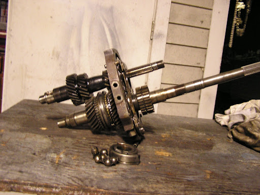

I have the transmssion down to this point:
P1010267
I think the gear on the bottom shaft on the right needs to come off to get both shafts out.  Any ideas on how to get it out?  Don't have a bearing puller that long...press maybe?

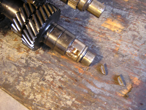

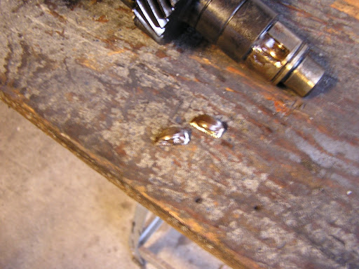

Also I found this on one of the shafts:
P1010265
P1010266
...this is a woodruff slot/keys.  They are pretty mauled up...wondering if I can get new keys and maybe weld and return the shaft on a lathe.  Any/all comments welcome...

...ah ed, give me a little credit!  I take machining classes at the local tech school, where we have a press.  I tool the chunk out there, and pressed everything out.  That shaft was for sure in pretty bad shape.  We welded the slots shut last night, and my plan is to turn it back down to size, and recut square keys (no woodruffs) and press the gear back on.  Hopfully will start the reassembly next week.

...re-machined the shaft, and pressed in new keys.  can start reassembly now...
