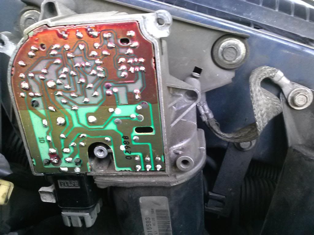

It could be the control circuit board on the wiper motor.
The Wiper Circuit Board is Easily replaced.
Its only one connector to remove and one screw to remove from the cover and you gently pry it out.  it can actually be re-soldered in most cases.
have a look.
CAM00522 Zps9p1bvzg1
Hint. also move the ground wire from the wiper hold down bolt to a different bolt on the firewall if it will reach.
