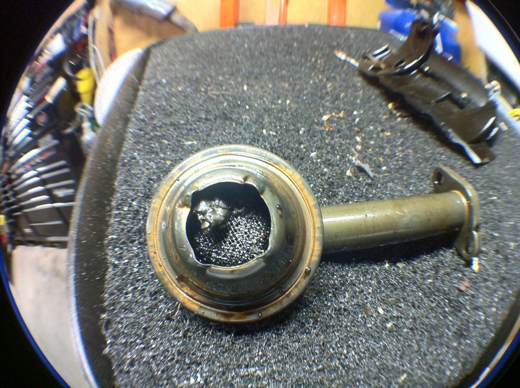

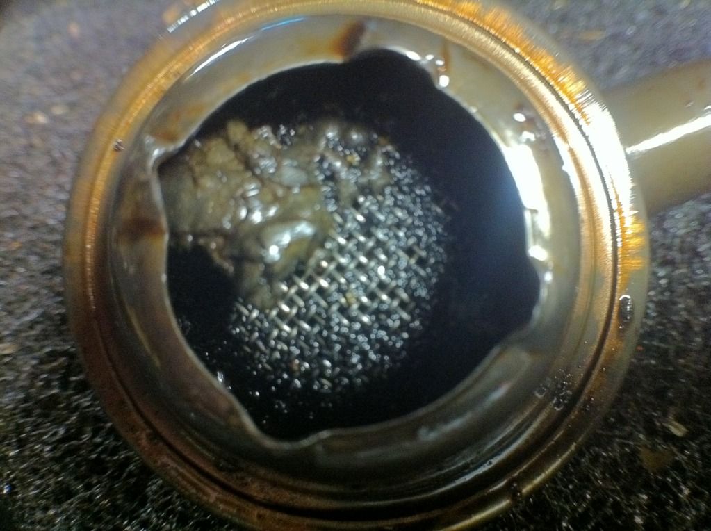

Just Try It1 Just Try It1
Moderator | Posts: 2328 | Joined: 08/14
Posted: 08/10/15
12:11 PM
Hari Nath... you need to find a mechanic locally..
you have serious oil system problems..
IMG 2306
IMG 2305
this is what is going to happen soon..
Rod Thru Case2

Hi friend,
Thanks a lot with the quick suggestion, could you please explain me what the images are about .
Thanks
Hari S
Posted: 08/10/15
10:15 PM
the upper images are the oil pump pickup screen in the oil pan.. the middle image shows the sludge that blocks the suction from the pump.. causing a lack of oil flow..
the lower image is not a water cooled VW..  but it is damage where the bearings were damaged and the connecting rods either seized on the crank or actually broke.. the rotating crank then came around and bashed them out the bottom side of the engine block..
