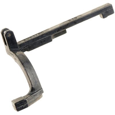

this is a long out of date post...
but... when the lock cylinder turns freely.. and does not activate the ignition switch electrical section..
there is a slide device inside the steering column ..
slightly earlier than mentioned models of the fords used an actuator like this...  this takes a professional about an hour to install..   without pulling the column..  this fits ford tilt columns 80 to 92
in 1992/93 ford changed styles of column..   there is a small pin that works its way out of its hole and then everything stops.. ...  either the key won't turn on the car.. or it won't turn off the car..  just rotates freely..  the column really has to come out of the car to get at this..  i have done them in the car.. but you have to understand.. i have been doing this for 30 years..
there are a few sites with instructions..
